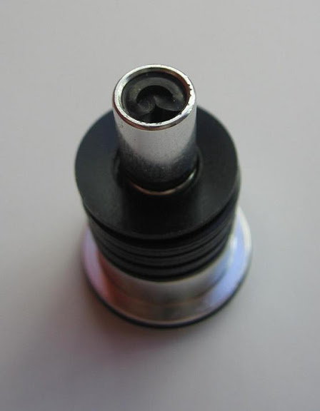

Old 06-01-2008, 05:31 AM #31
kert.
kert.'s Avatar
Location: Estonia
The picture says it.
kert. is offline   Reply With Quote
Old 06-01-2008, 10:16 AM #32
xluben
Ben Johnson Photography
xluben's Avatar
Join Date: Jun 2002
Location: Minneapolis, MN
xluben is a Paintball photographer
xluben plays in the PSP
xluben owns a Planet Eclipse Gtek
xluben posts videos on PbNation
xluben supports Ninja Paintball
Exactly the type of thing to look for when you are having issues!
Do you suspect this was user error, or a defective part?
xluben is offline   Reply With Quote
Old 06-01-2008, 04:35 PM #33
kert.
kert.'s Avatar
Location: Estonia
Don't know. Allthough I hadn't "bottomed" it ...

Old 06-01-2008, 06:29 PM #35
Lucky4143
Jason Vitalich Fan #1
Lucky4143's Avatar
Location: Monterey-CA-831
Lucky4143 owns a Planet Eclipse Ego
no extra reg seats will come with the fusion

Old 06-01-2008, 07:04 PM #36
MstrKey
Join Date: Aug 2001
Location: SSM, Ontario, Canada
MstrKey is a founding member
MstrKey is for the Gunfight
MstrKey supports our troops
Those look the same as the dye reg seats. If you know anyone with a new Dye gun, they'll probably have one you can use. Reg seats are cranked out in factoies by the thousands......it's not unusual to have defective ones. This is why I always suggest everyone take their gun apart when they get it. Just to look things over.
That shim stack issue is also a problem. You need shim that sits flat on each end of the stack.
