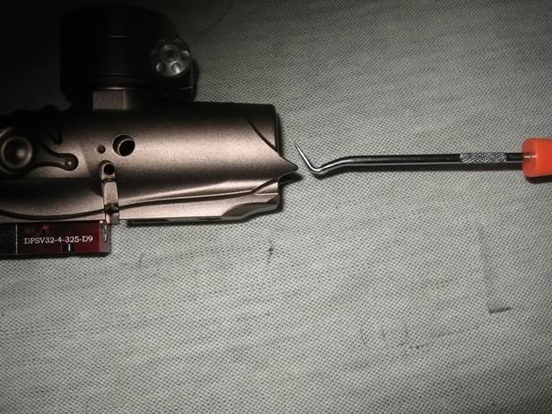

Step #4 Remove the bolt from the body and wipe the bolt and O-ring clean. Don’t forget to clean the inside rear of the bolt with the rag also. Replace any damaged O-ring and then reapply the 50/50 mix lube on the 3 O-rings, located at the front of the bolt. Notice that it doesn’t take much. Too much lube will cause FSDO (first shot drop off), or bolt stick. I also lube the bolt in this area so that it will lube the internal O-ring in the body when the bolts replaced. The outside of the bolt doesn’t need lube anywhere else. If your bolt sticks and won't cycle once aired up, the #3 oring is usually the problem.
It seems like bolt stick. Use a SWELLING lube on the #3 oring and let it seal. If your marker doesn't cycle after it has swelled up, you will need to replace it.
At this time you should clean in internals of the body. Just wipe clean what you can reach with the rag. The front chamber, feedneck, and barrel threads should be wiped clean. If you have had a ball beak in the chamber, the eye covers should be removed, using the 5/64 allen wrench. Use the pick to aid in the separation on the eyes and eye wires from the body. Be careful with the eye wires. Clean the eyes, dents, and eye covers from all paint before replacing them on the body. The dents don’t need to be lubed.

Threshold Trigger Removal
Before beginning, refer to the ďComplete Separation of the Thresholds Body and FrameĒ.
Once you have removed the frame from the body you will be able to begin with this section.
This section is for anyone changing out there trigger or installing a Magnetic Rendition Trigger Kit.
All that is needed is the 3/32 allen screw.
Step #1 Remove the Trigger mounting screw with the 3/32 allen wrench.
Step #2 Remove the trigger out of the top of the trigger frame.
Step #3 Take note on where the trigger return spring is located. If you are installing a Magnetic return, this is where you will be super gluing one of the magnets.
Step #4 This picture shows how the trigger sets inside of the trigger frame. At the far end of the trigger directly above where the spring looks like itís going to touch the trigger, this is where the second magnet will mount for your magnetic return. Make sure that the magnets on both the frame and trigger will repel one another before you super glue the second magnet.
To put back together just reverse the steps.
ENJOY!
