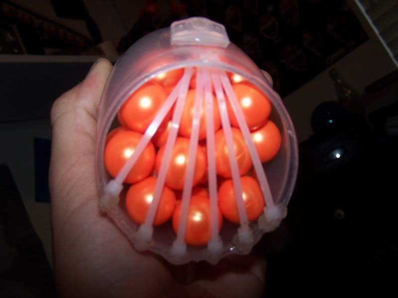

I know this isnt the hopper forum but since it is us pumpers that use them I figured it should go here......Anyway I did this because I dont have 10 round feeds and dont want to buy some seeing as I also dont have a harness for them (or money).
I started with a regular BE pocket hopper and ripped off the lid. I took a sharp point (knife not advised) and poked a small hole where I wanted the flaps to go through. I then took a small flathead screwdriver (or staking type tool) and enlarged the whole into a rectangular shape big enough for a small ziptie to go through. I then put the ziptie through from the inside out and went in a circle to latch it so that the flaps would be arching outward. i did that as many times as needed (6 for me). Then I held the base of where the ziptie starts so that the end would be where I wanted and hot glued the base of the ziptie to the hopper. Once you do that to all the flaps, you're done.
NOTE: the flaps will be stiff so you'll have to bend them back and forth to to soften them. Must use the 4 in. x 1/8 in. (ish) for this to work properly.
And now for the finished pics....

pretty clever use for"fingers", and it looks very clean. Good job

Why don't you just cut a hole on the hopper lid for 10 round tubes, if that is what your using it for. Anyways, still a very nice job, very clean.

I dont have 10 round tubes....or use them for that matter....plus I wanted to be original and come up with something myself

Ya but they have speed feeds out for halos...and I wouldnt want to worry about cracking my halo shell when i could spend 10 bux for a speedfeed....but i like lids on my halo; i just did this cause the lids on these sux

My goal was to use with PODS....not 10 round tubes....(like I've said 3 times)....so it's still original

Lets be realistic here, i've seen "speed feed" pocket sized hoppers aside from yours and the thread starters. And pumpenstian(sp?) used speed feeds on thier hoppers [althugh actual sized]. Difference is the materials used and his "design" if you will of the fingers i found original and usual. Otherwise homebrewed speedfeed's on hoppers pretty much lost any originalty.

Now try shaking it.

I did....I actually thought about throwing at the wall cept the shell would prolly break......nothin came out and I shook it HARD

put a vid of you dumping balls in and holding it upside down then i might try it,it doesnt look like it works and in the pics the hopper isnt full is that because you were worryied about it not working

those hoppers dont feed right when full
