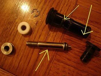

4. Have your stock ram shaft polished from that dull silver and rough surface to a mirror like finish that you can actually see yourself in. This makes the ram shaft smooth as ice and has a better fit in the ram sleeve for much less friction.
5. Have the INSIDE of the ram sleeve polsihed like the ram shaft. By doing both of these, it allows the ram to move more freely. Usually it is a tight restrictive fit. When I tilt my gun back and forth the bolt assembly and ram moves back and forth. Thats how the ram SHOULD be able to move.
6. In the ram sleeve, you will notice there are holes in the front and back. These holes allow for air to enter and exit the ram allowing for the ram to move. I machine in more of these port holes... but that's not all, I actually add more and even INCREASE the actual size of the port holes. This causes for a double in flow to the ram.
Here's a pic of the ram shaft and sleeve, you can see for yourself how shiny the ram is.
