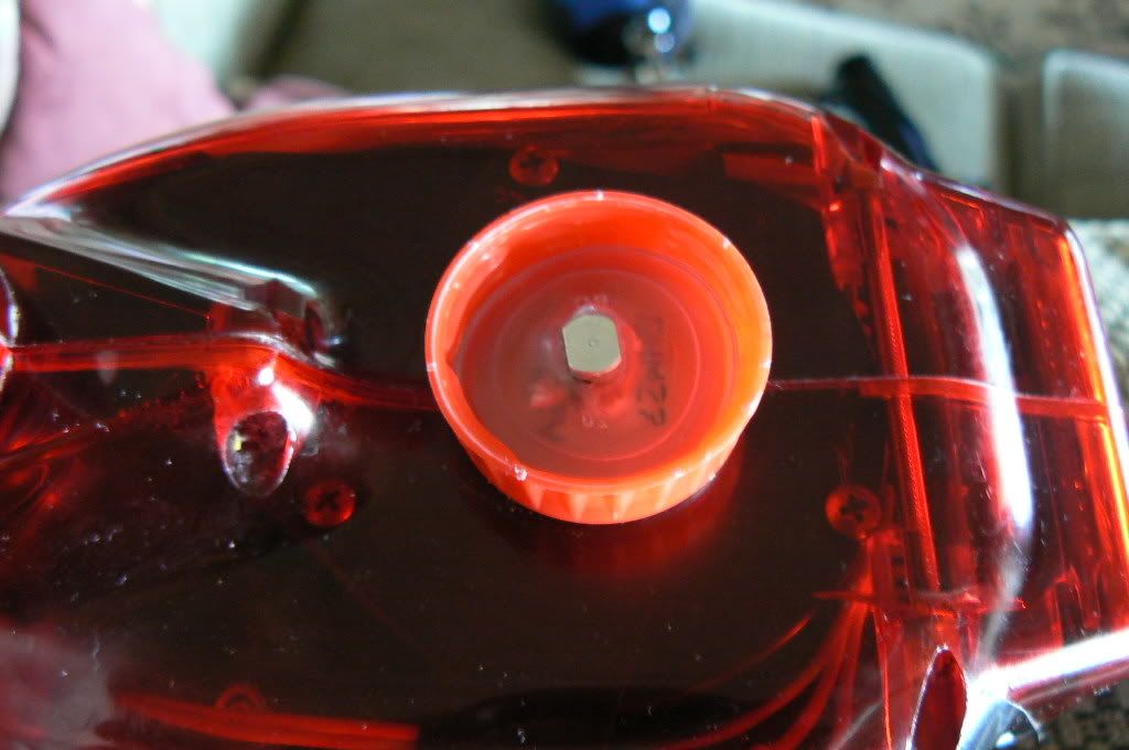

Or if you more of cheap *** then you can do this mod:
Mod made by:ChEeSeMaStA18
Parts you need:
MT dew cap (or any)
screw driver (flat head)
and a hammer
Ok, so you take everything off your rip drive. Next you take your screwdriver
and put it in the middle of the cap. Kinda make an outline of the rip pole. Now
pound the **** outta it till you got a hole that fits firmly on your rip and make sure
it doesn't wobble or come loose and is centered.
Pic:

Since this thread is all about halo, I decided to put my review/comparison between Hybrid Suicide Shell and Powerlyte Cranium Shell here.
These are a Red Camo Powerlyte Cranium Shell ($36.95) and a White Hybrid Suicide Shell ($50).
Cranium Shell comes with a clear back plate and magnetic lid. As for the magnetic lid, it's very secure and only one finger can pop it up. However, you will have to use some tapes in order to fit Speedfeed on Cranium.
As you can see from pictures, the bottom part of Cranium is molded as one piece while the Suicide has two pieces as same as halo stock shell. The another nice feature is the tray. You just remove two screws at the bottom (Suicide has five screws) to take the tray off in order to reach the halo engine. It's a huge advantage from Cranium especially when you get hit at the front of your hopper, it's such a pain to take apart the whole thing at night after your game day (you can skip this part if you have never cleaned your hopper though).
One more cool feature ! You can install your board and back plate without damage. Well, pictures can tell you everything.
Finally this picture shows everything you will get from Powerlyte. Please note that the camo pattern is printed with clear layer on the Cranium Shell which some damages on color are found around the neck after field tests. I'd say Cranium Shell wins this round because not only Cranium Shell has more cool features than Suicide Shell, but also less expensive.
Hope you guys enjoy my review.
