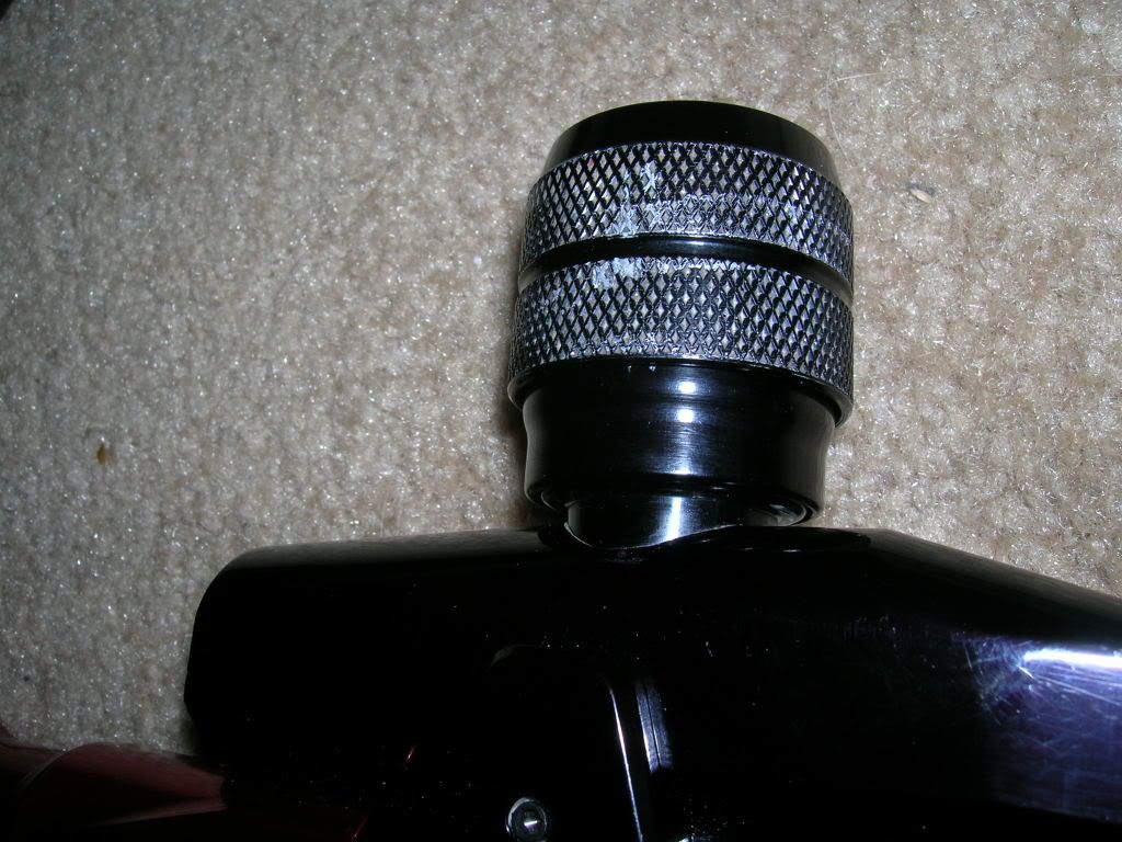

tbs5391
tbs5391's Avatar
Join Date: Jan 2004
Location: Back in New Jersey
Im pretty sure that feedneck is a cocker, can you clarify this?
The only reason I would think its not is because it is on a ripper 2, but who knows, the guy i received this from stated it was the 2nd ripper 2 that was assembled.
EDIT: Pic killed margins, so i resized.

Old 03-29-2006, 09:36 PM #16
paintballer187
187PB.COM
paintballer187's Avatar
Join Date: Dec 2001
Location: U.P. of MI
paintballer187 is a Moderator
paintballer187 is a Supporting Member
paintballer187 works for a Paintball manufacturer
patrice - yes you could get a cocker threaded base then put it on your teammates dragon. i would suggest not going with cocker, I would suggest a 2k2 threaded base. contact BLAST for one.
tbs5391 - if you compare it to the pics you can tell that it's 2k2 threaded.
