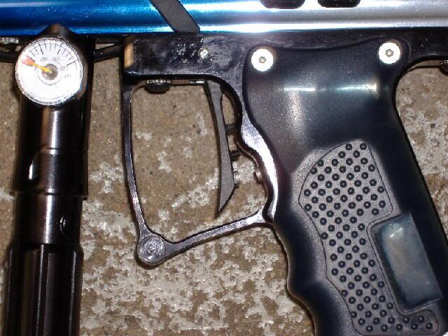

you put one magnet on the bacl of you trigger, and one right behind it on the frame repelling it. The force of the magnets repelling makes the trigger return faster and its easier to walk. There is a picture of my wrath w/ magnets in the pictur thread. I think its like the second to last one on there

ya find squints pic, and you'll see how to

sweet. Ok first, you must buy some Radio Shack 1/8" rare earth magnets(package of two. Then, to make it easiest, tap the pin out of your trigger and take your trigger out. You can either put glue on the trigger first or glue on the magnet, either way its fine, and then you place the magnet on the trigger. I find the best feel to be at the bottom of the trigger right where it lines up right before the curve on the frame. Then, you find out which side is the attracting side of the trigger and put glue on that side so it will repel. You then place the magnet, attracting side down, onto the frame wherever you feel you want it at.(To repel, each magnet needs to be almost exactly across from each other.) Put your trigger back in the frame, make sure eerything is lines up, push the pin back, and rip.

Here's a pic of Squint's Wrath

yeah it works good, and with the 3-point adjustablility on the fbm triggers, you can adjust the force of the magnets by either setting the trigger so it sits far away for less force, or bringing it right up to the magnets for a lot of force.
